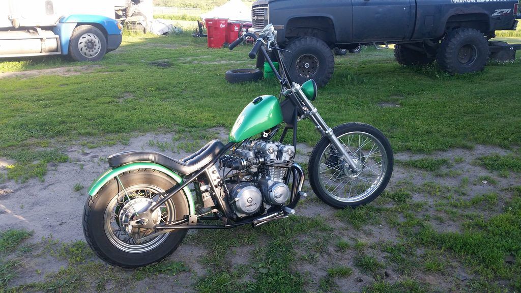

      Im still on the dual carb quest. Did you end up building your own and if so, how and do you have pictures?
      Also, my bike looks a little different since I posted this. The crappy lighting in the pic doesnt do the green any justice at all.
