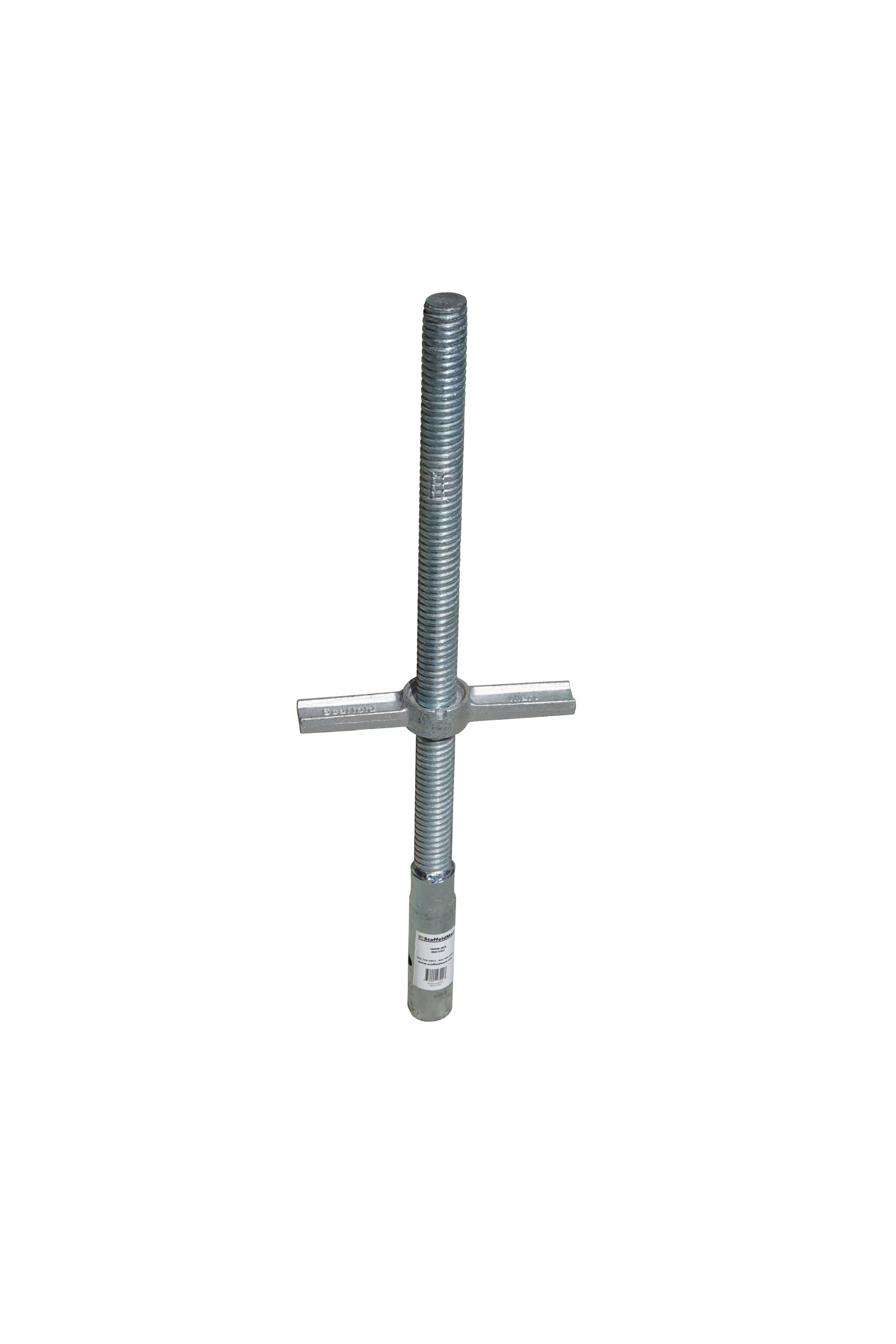

      It gave me one too when I first checked the prices after scoring used scaffolding casters. I just never thought they'd cost so much less than flat topped casters for a much more versatile, stronger part that swaps so quickly. The pipe sections I showed in the pics are referred to as "receivers" in scaffold parlance. That pipe can accept these "caster jacks" too:
      Caster Jack - Scaffolding Accessories - Scaffold Jacks - Caster Jack -Scaffolding & Scaffold Accessories at the Best Possible Prices-
      I'm adding more receivers so I can raise equipment using the jacks to easily remove casters to use elsewhere. That's what caster jacks (I need to order some but pantograph jacks will do for the moment) are for and they can be left in place or also removed if the user wants a different "foot" to support their machine. Most caster jacks are Acme thread making them quite stout.
